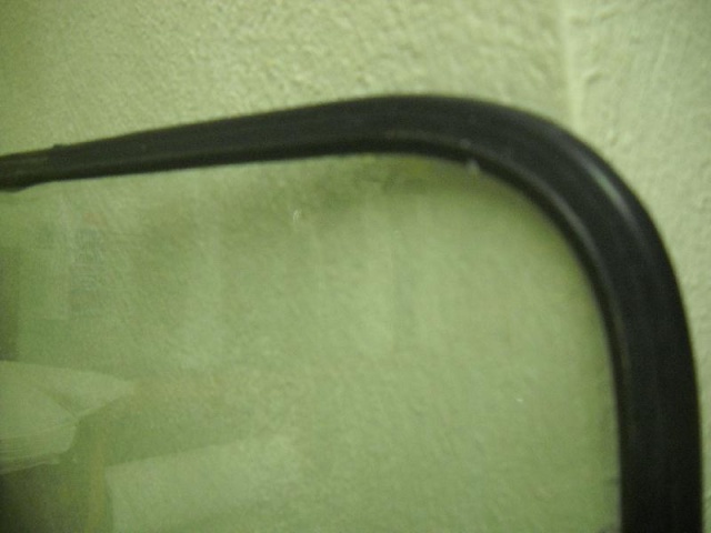

Post by Van crazy on Sat Apr 26, 2014 1:51 am
Hi Donivan I am not using the original rubber I am wrapping the glass with silicone tape then installing into my frame it is a very tight fit. I will get some pics on that when I set the next window. The stuff I use is called "Wrap It" I got it at auto zone it worked great being silicone flavor it is very hard to tear.
Number of posts : 533
Location : buffalo ny
Age : 42
Re: Pop-Out Window Frames
Post by Van crazy on Sat Apr 26, 2014 8:51 am
I took the glass out of the frame I had on the van this is the rubber I used on the glass works great!!!
