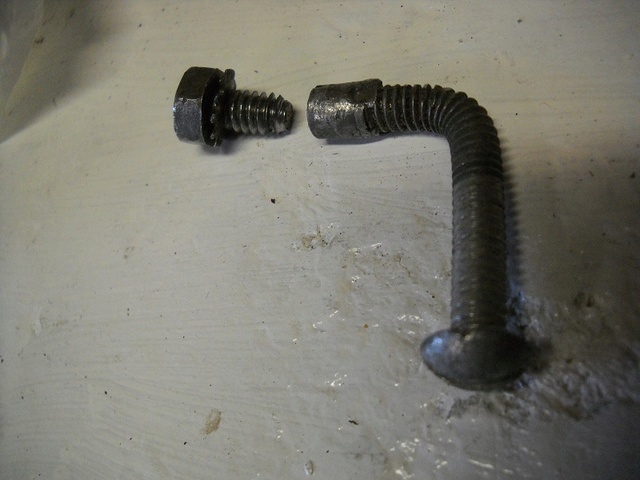

That is absolutely amazing!! I had to read this over a few times to understand how you extracted the bolt. I wouldn't have known that the opening for the fuel pump went through to the oil pan.
But I still have a couple questions:
When you came up one bolt short, what made you think it would be in the oil pan?
What the heck is that thing hanging out of the oil drain hole that looks like a long, bent bolt?

Well,,,,I put the 24 bolts in the pan to hold the new gasket in place to set up the RTV,,,,and somewhere along the line one bolt fell down into the pan,,,,,,there is a baffle in it so you cant see the bottom of the pan,,,,,I put the pan up,,,,,,and when I was tapping the pan up with a rubber mallet to seat the rubber seals on the pan,,,,,I heard a noise in the pan,,,,I pull the plug and run a magnet into the pan and there it was,,,,a bolt laughing at me,,,,saying come and get me,,,,,however, the bolt head and the spring steel lock washer are bigger than the plug hole so it wont come out through the oil pan drain hole.
I decide to make a tool to screw on to the bolt so I can hold it while I run my Dremel tool into the hole and grind the bolt down far enough to come out,,,,,but that spring steel lock washer keeps spinning and I am not liking the grindings falling into the pan,,,,,,so I go to plan B,,,,a coat hanger through the fuel pump hole and tie the bolt to it and pull it out that way,,,,,,I look at a spare engine and see that there is a lot of twists and turns around the bearing caps, crank journals, oil pump and screen and pan baffle to get that coat hanger go in the fuel pump hole and out the oil pan drain hole,,,,,so on to plan C,,,,,,
I find a parking brake cable with a ball on the end and it is flexible enough to find its way from the fuel pump hole all the way out the drain hole and I tie a wire from the bolt to the ball and ,,,,OUT IT CAME!!!!!
