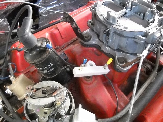

,,,,and then I stop by Jackes on my way home,,,,,I left her my test equipment yesterday for her to use,,,,,,,,
,,,,,,HOWEVER,,,,,
she tells me that her idea of pouring gas down the carb to keep it running kinda sorta BACKFIRED on her,,,,,there does seem to be soot on the roof and she has some sort of tan now,,,,,,,,so I hook up the clear line and pull the coil wire,,,,,,hey,,,there is gas,,,,,but it is BLACK,,,,,,it runs clear into a bucket,,,,,,probably from that old long rubber hose from the fuel pump to the carb,,,,,it still wont start,,,,coil is red hot,,,,,there aint no ballast resistor in the line,,,,,,,points are burnt,,,,so she can get new points, condenser, ballast resistor and fuel hose,,,,,just to get it running again to finish the rest of the tests,,,,,,I surely think that fuel filter sitting right next to a 500 degree exhaust manifold aint helping things,,,,,,,but she showed me she put on new grab handles above the doors today,,,,,,,,

so I stopped by Jackes place to see if she left me points, condenser, fuel line and ballast resistor,,,,,the points and condenser gets it running again,,,,,,,I pull the steering wheel off,,,,,,the upper bearing has popped out because that fake steering wheel aint holding the bearing down like it should,,,,,,,I left her a new switch for her to put in,,,,,,she needs to shim up that wheel or put the correct stock one back on,,,,,,there is no boost wire coming from the starter solenoid,,,,the voltmeter on the dash reads 20 volts,,,,,she can put the ballast resistor on...add some boost voltage wiring,,,,,replace my clear fuel line with rubber,,,,and road test it,,,,,,there is no timing marks on the timing cover,,,,just a notch on the balancer,,,,,,,Zack came over for some parts for his van,,,,,,and there they are,,,,the V8 twins,,,,,,,
