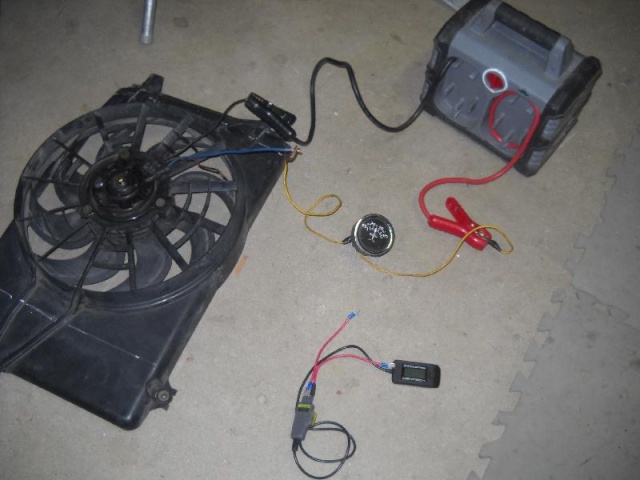

No amp test yet, as I am not sure how to do that, or what equipment would be needed to do an amp test.

,,you need an Ammeter like the two I used in my video to measure the amount of current that a fan uses while running,,,,,you just put it in a line and it shows what is flowing through it,,,,,Sy says his Ford took almost 60 amps to run it,,,,,and Vic probably says 37 amps,,,,,that is really using up a lot of juice,,,,,,the van might not even start if you left the fan on too long to cool down the radiator.....

I will have to pick up an ammeter next week or borrow one and see what mine is drawing. Can't get your video to run but I get the idea of how you explained it by putting it inline. I presume you put it on the positive wire?

An Ammeter goes in a line,,,,,dont matter which one,,,,,just tells you how much juice is going through that wire,,,,,,,you NEVER want to hook it between Positive and Negative,,,,,,you could have 800 amps going through it if you connect it to a car battery that way,,,,,,bad stuff WILL happen,,,,,,now in my pictures here,,,,I got an old car ammeter,,,,put some wires and alligator clips on it and hook it between a wire,,,or,,,I gots me a fancy digital one,,,,,made to plug into a fuse box to see what is blowing fuses, and I did the same thing to it,,,,some wires and alligator clips so I can test what is going through a wire while the equipment is running.......
