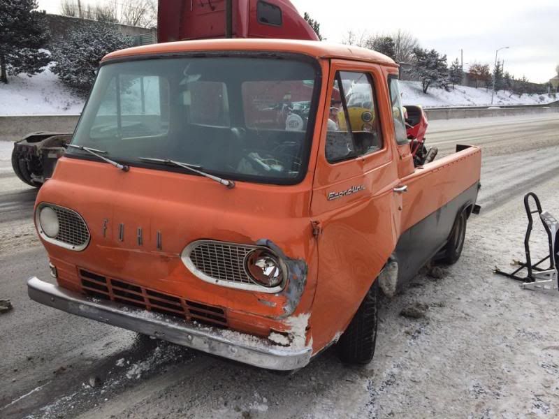

Thank you all for the sympathy and help! Here she is:
I will certainly need a new driver side door and front bumper, possibly a grill and some shift linkage steering and pedal parts. I will be calling SC autokraft today to see if they are willing to take it on. Let me know if you guys have any parts I can buy!

Looks like most of the impact was up around the headlight bucket. If the frame rail is ok that is repairable. You will need a door. Thankfully, you didn't get the windshield.

To buckle a door like that, the door pillar was pushed back considerably. That's going to be hard to fix. Look in the footwell and on the floor for buckling. That's a pretty good lick. I'd let a few bodyshops have a look at it and see if it can be pulled back into shape. You may be better off swapping your drivetrain into another body. These things are made out of some thick steel and it doesn't like to move. Good luck on the repairs.

The floor is buckled a bit. We will see how it goes.

BEST thing is that your okay,,, NASTY lick in the front and agree that the pillar is bent, and highly suspect you will find a buckle in the frame area behind the steering box.
The pillar is hollow and will be a bear to straighten correctly. I have seen a lot of doors that dont fit right when hit less than that yours has been hit. No matter what the shop does, if the pillar isnt exactly on the money the door cant be adjusted to fit correctly.Vans and pickups identical to each other.

I agree with Duane, that looks like it will have a lot of "hidden" damage. The framework on these pretty much suck. They are paper thin and you have a lot of stuff connected to the frame were you were hit. As much as they might say they can fix it, you may have a lot of problems they don't see yet.

That's a shame. Looks like it was a pretty nice one. I'd surprised if the floor and step weren't buckled. I've seen 5 window pick ups come up fairly cheap on craigslist from time to time. There was a 5 window came up on CL from Cle Elum, I want to say they asked $900 for it. Saw another a while back in Spokane I think, 2 pickups asking $2400, I think one was a 5 window.

That is going to be a HARD Fix the cab looks Buckled.!!. I hate to say it but your Best and Cheapest way out may be to find another body and change everything over ..I am with Everyone also I dont think you will ever get a new door to line up right..Crying or Very sad....JMO
