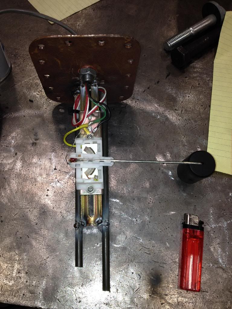

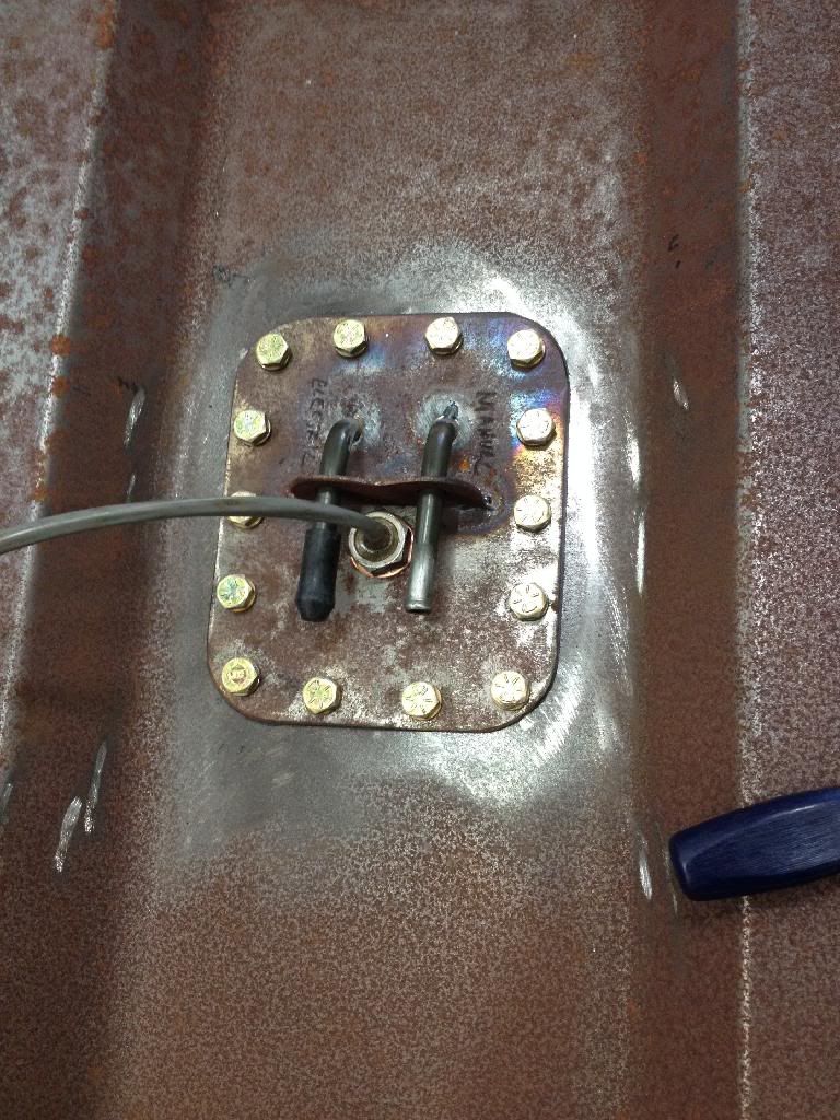

So here is what we got done in the last few days. Saturday we raised the Sportvan up on the rack and my friend Eric tore into the trans to change the clutch. When we switched out the engine we knew that clutch was done but couldn't get one that day. Now that work has slowed down we decided its time to get back to the fun stuff. The new clutch works fantastic. No more slipping. Moving to the rear, we finally got our home made gas tank completed. I finished the sender unit. Plumbed the tank, refitted the filler neck and and filled it with gas. The final tally was 21 gallons. I was hoping for more. I might have an air pocket that is slow filling. I didn't try to top it off.

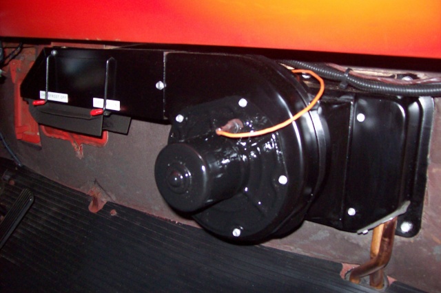

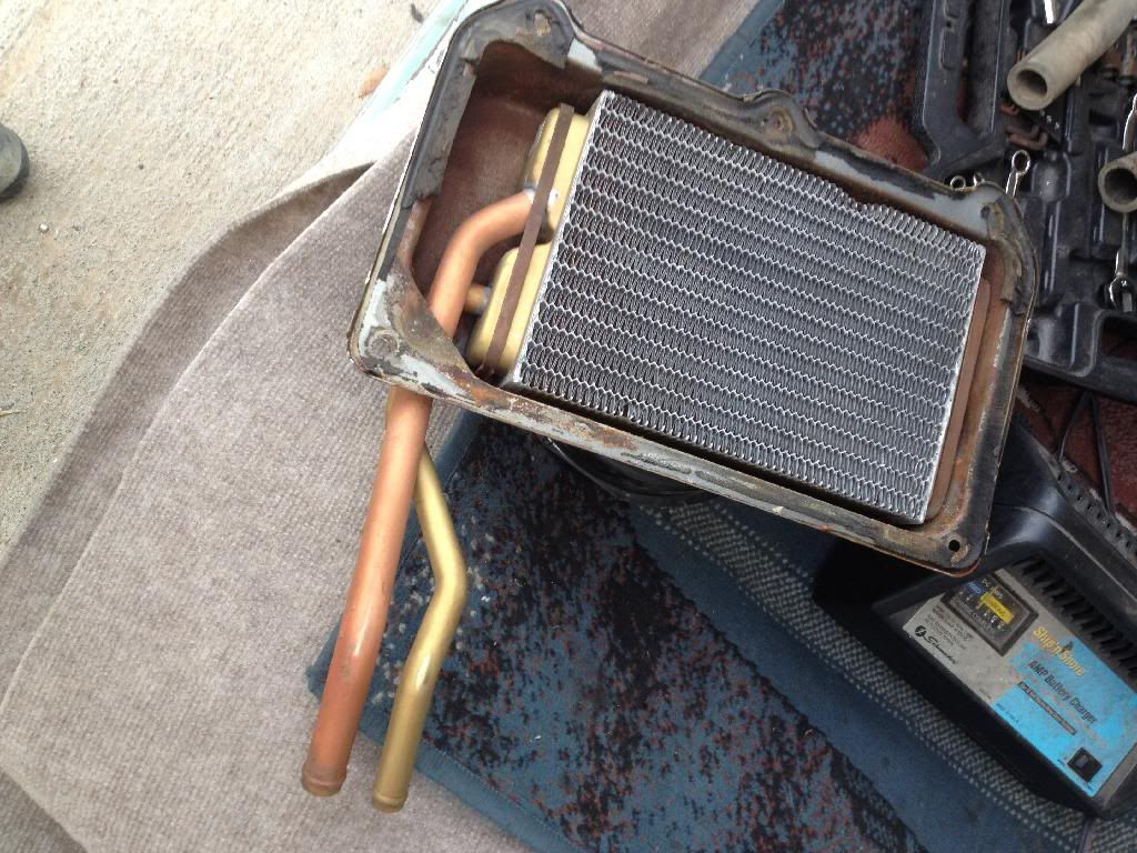

After that I finally got to put in the new heater core. That mutha F'n heater box was glued on so well! It's really nice to have a defroster on the window, not to mention my girlfriend likes the warmth on her feet.

This is the sender wired up. The red and white wire are for fuel pump later.
Here is the sender installed. I made a bulk head fitting for the wires to pass through. The 2 fuel lines are for a return if I choose to do fuel injection later.

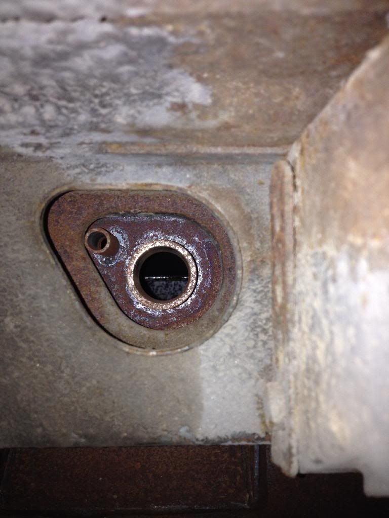

This is the filler and vent aligned with the frame.

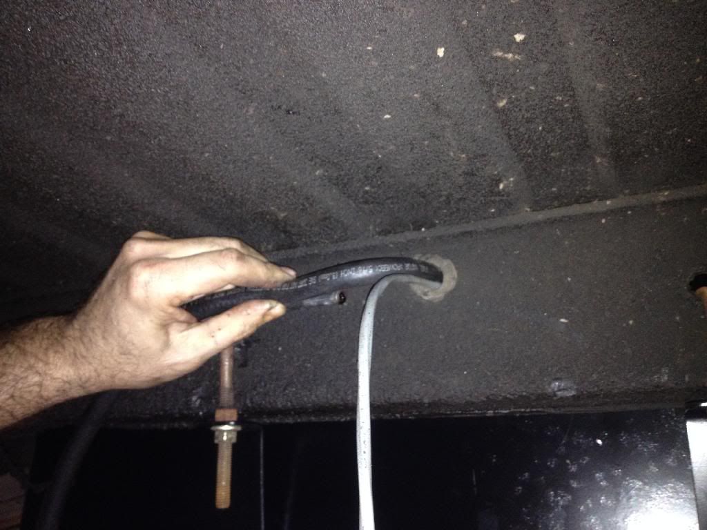

The fuel hose and sender wires pass through the original location.
The first time since I've owned the van to put fuel in this location.

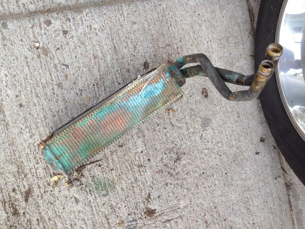

The old heater core was leaking.
New heater core fits like a glove!

Anyone have a pic of what was on the bottom of the floor vent? I have 4 screws aiming at the floor holding bits of plastic to heater control box. I imagine it was a deverter?

Post by Joe Van on Mon Dec 16, 2013 4:23 pm
Number of posts : 9732
Re: Recycling a 65 sportvan custom.
Post by vanny on Mon Dec 16, 2013 5:24 pm
Pretty as a Picture! Looks Brand Spankin New!

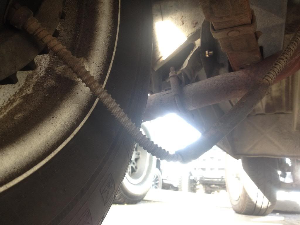

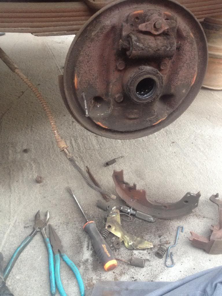

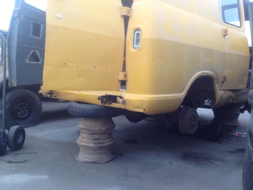

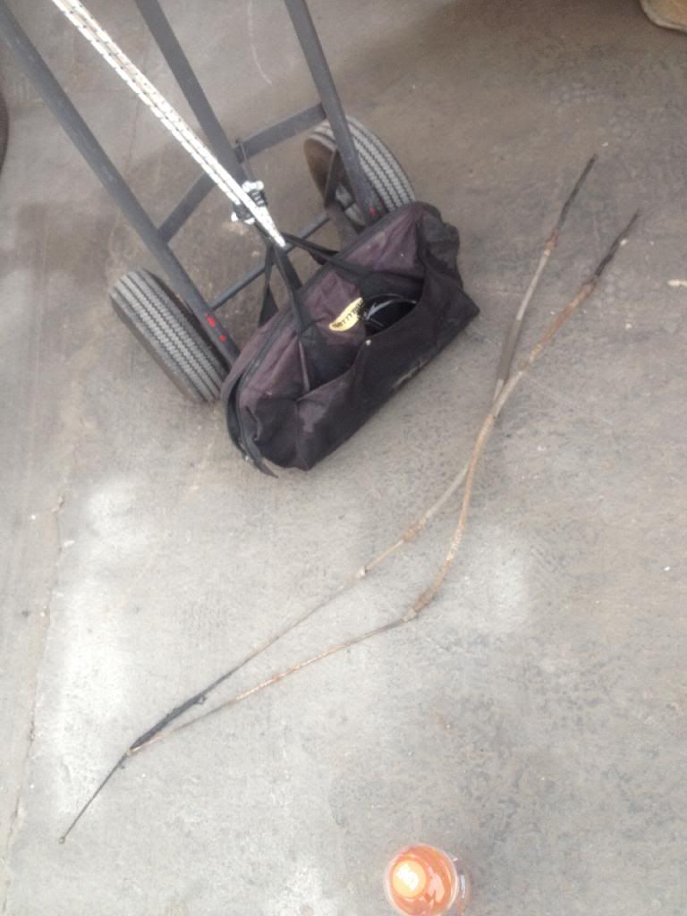

Thanks to the junk yard page I finally got some e brake cables for my van. I tried to keep the area under the van clean. I noticed someone really did a nice neat job getting parts out from under the old panel. I removed the brake shoes to get the cables out then put the brake hardware inside the right rear corner of the van. After that I reinstalled the brake drums to keep any weather out.
The old yellow panel had no straight sections left.
The left side brake hardware was new!
This is my broken stretched out e brake line from the forklift hitting it.
Success, two fully functional e brake cables.

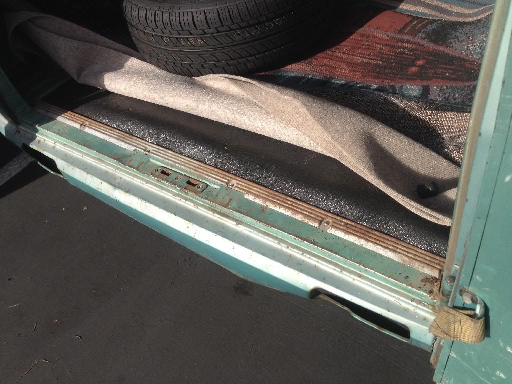

The only other thing I wanted and it looked like someone beat me to it was the door sill trim. I need one for the side door if anyone has a spare.

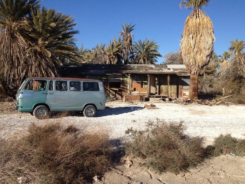

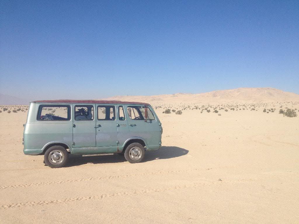

Went for a great drive today. Here is vid https://youtu.be/rVS-OK4AtgU
More pics to come.

Congrats on the successful trip to Egypt and back! LOL What did the sign say??? scratch

Superstition mountain. I used nearly a full tank of gas. The poor thing needs an overdrive. Lol I stayed around 62mph but the the little 6 sounded wound tight.
