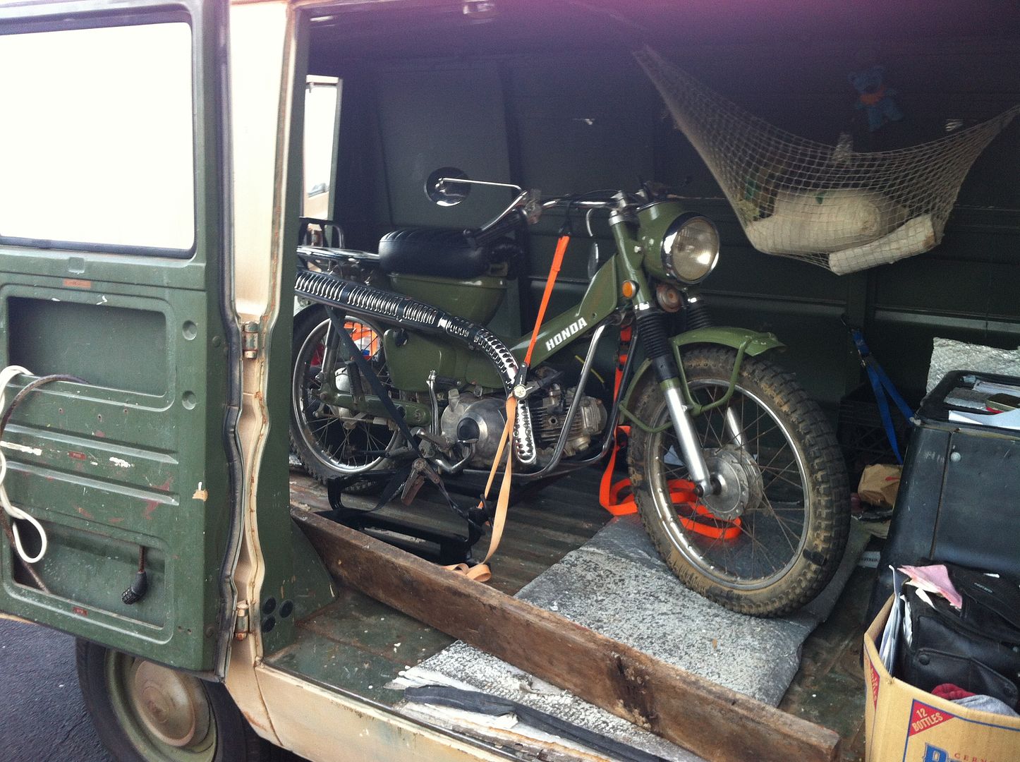

No real progress on the van, but I did just pick up yet another vehicle. A 72 Honda trail 90. It matches the van... Very nice to be able to pull the back seat in 5 minutes.

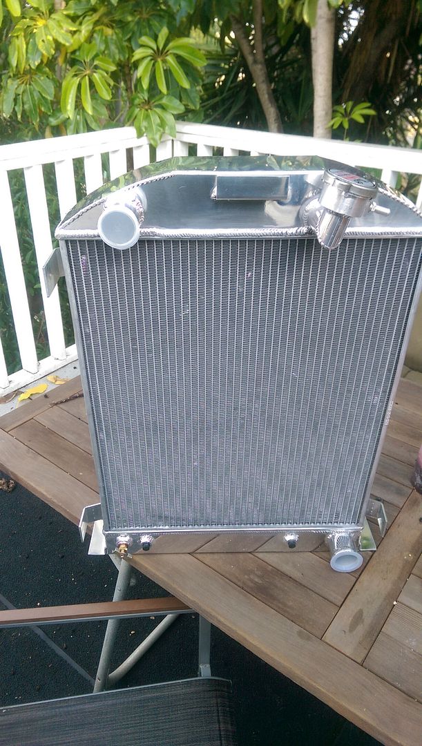

Post by Dawgboy on Thu May 21, 2015 6:57 pm

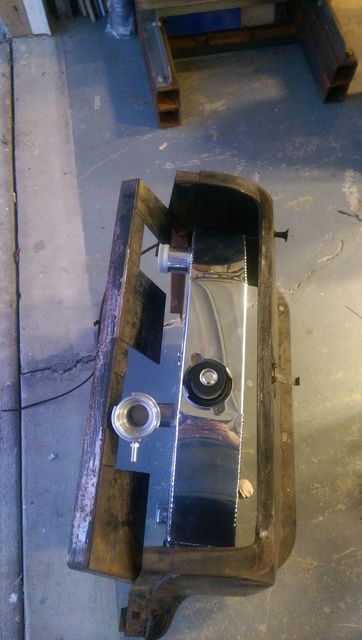

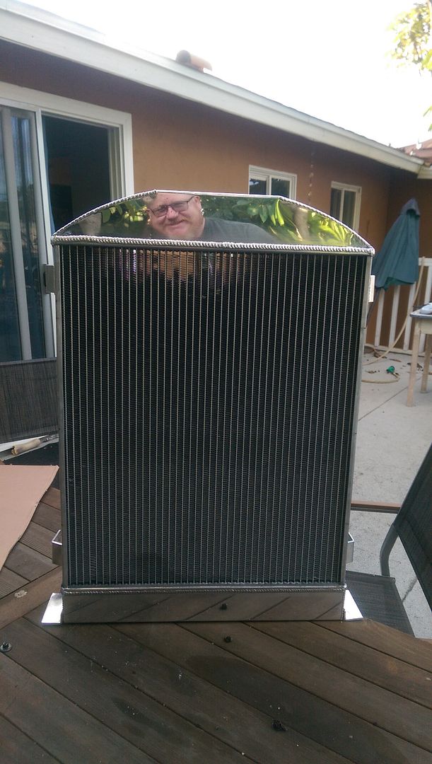

Well, Here it is. Very shiney! Not sure how I am going to fabricate a new mount, but I am motivated. Barring rain, Saturday will get the van up and stripped out, so I can compare the two and do a trial fitting. Its about an inch thicker on the tanks, but otherwise looks a good fit. It's more than double the core thickness Very Happy

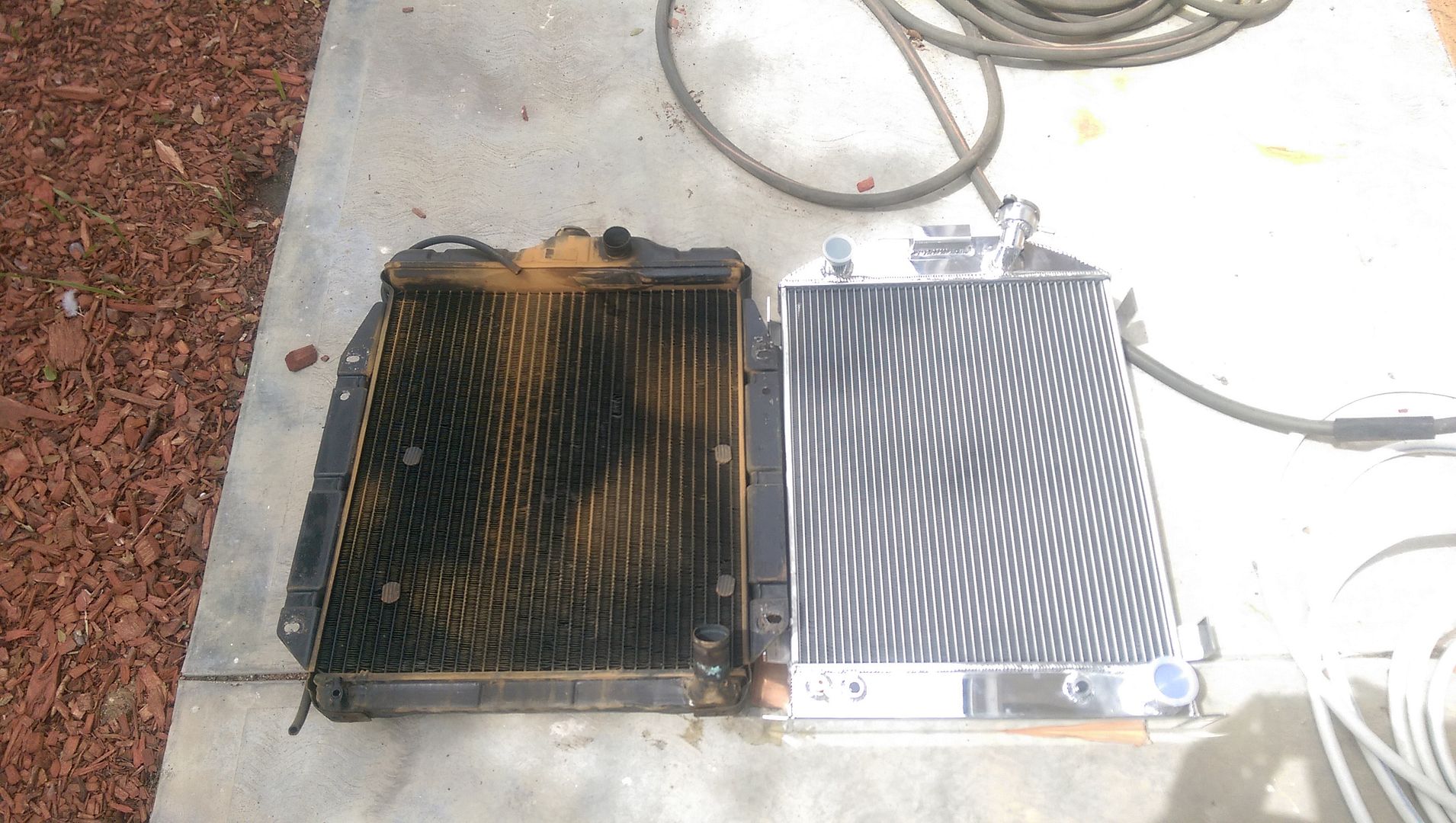

Post by Dawgboy on Tue May 26, 2015 4:10 pm

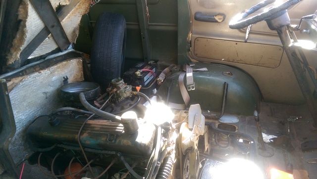

Worked on the Van over the weekend. Pulled all the crap out and put the rear seat back in. Then pulled the radiator to take it and the new unit to a friend who is going to Tig weld mounting flanges to the Aluminum Radiator. If I'm not too tiret to picj the van back up, I'm going to scrub out the tunnel and mat black it with Rustolium paint. As is normal, The Dawgvan requires blood sacrifice with every upgrade...
Dawgvan: A '64 A100 Build thread - Page 6 IMAG1318_zpsboronys7
All this is getting painted black so it's invisible through the grill
Dawgvan: A '64 A100 Build thread - Page 6 IMAG1306_zpsgzrqskqj

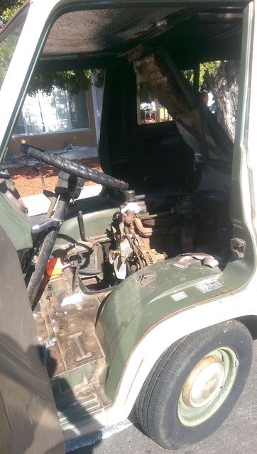

The comparison:
Dawgvan: A '64 A100 Build thread - Page 6 IMAG1310_zpsqrpqrjku
You have to get it WAY UP to get the radiator out (20 bolts and screws, it's really very easy)
Dawgvan: A '64 A100 Build thread - Page 6 IMAG1307_zpsj4fyf3qp
Dawgvan: A '64 A100 Build thread - Page 6 IMAG1309_zpshmme3bev

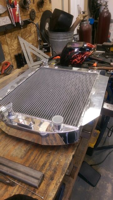

Post by Dawgboy on Fri Jun 05, 2015 9:37 am

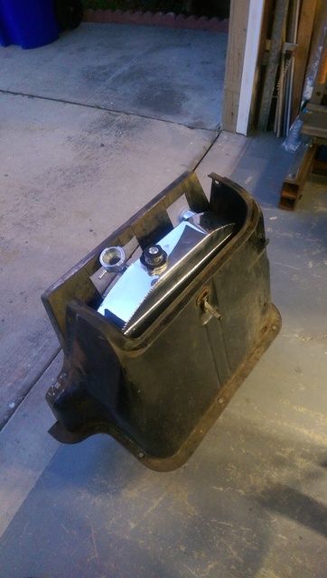

Pardon the details...

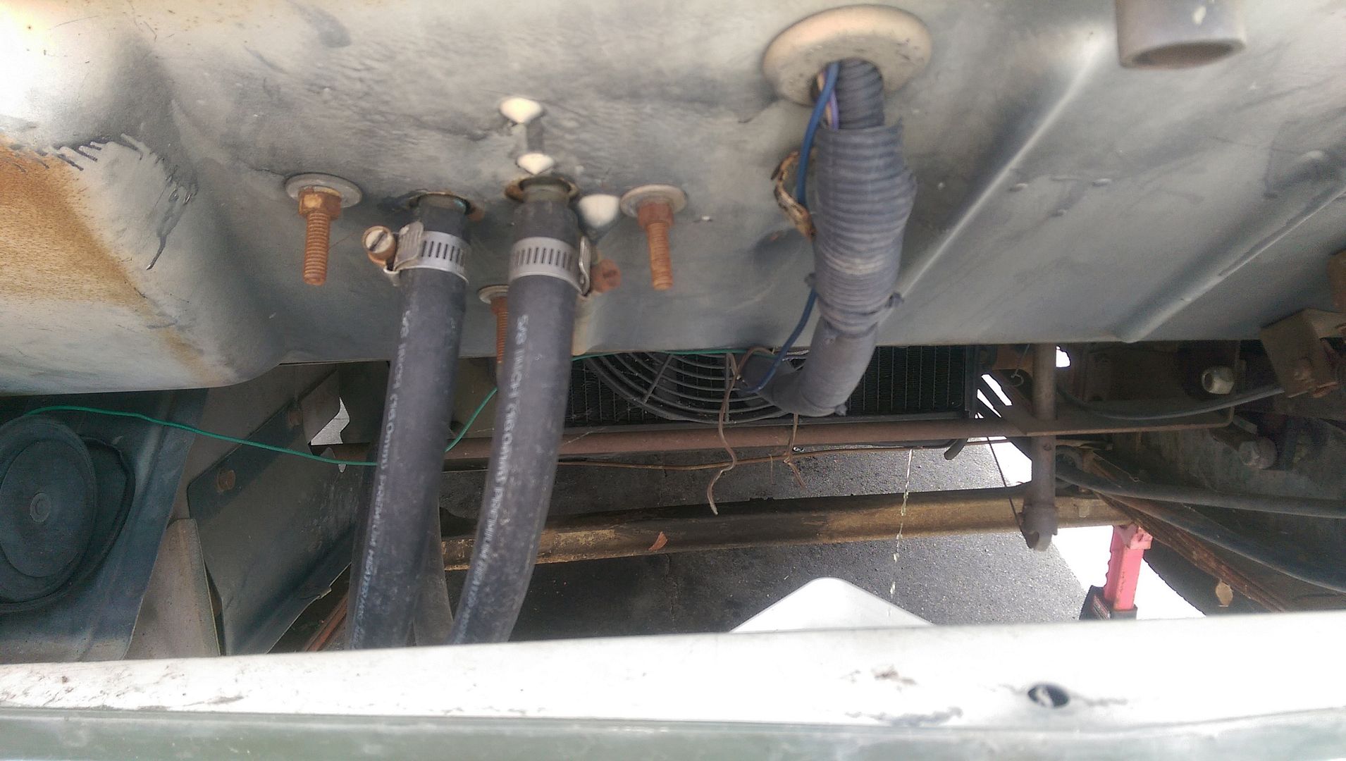

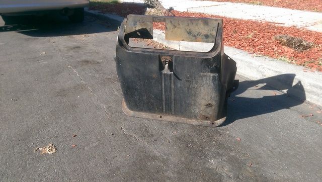

More Progress. Last weekend, pre-food poisoning, I pulled the radiator shroud out of the van and that was a real PITA as it was held in with 4 bolts with captive nuts that all spun out of their captivity. I had to gain access to the backside and vicegrip them. the last one took 3 hours as it was right up against the master cylinder.
Here is what the the sroud looks like and where it sits in the van:
Dawgvan: A '64 A100 Build thread - Page 6 IMAG1345_zpsx7nocuws
Dawgvan: A '64 A100 Build thread - Page 6 IMAG1344_zpszxnidg48
Dawgvan: A '64 A100 Build thread - Page 6 IMAG1343_zps4le8pbmb
I am going to paint the floor in front, and that housing piece before re-install.

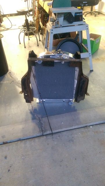

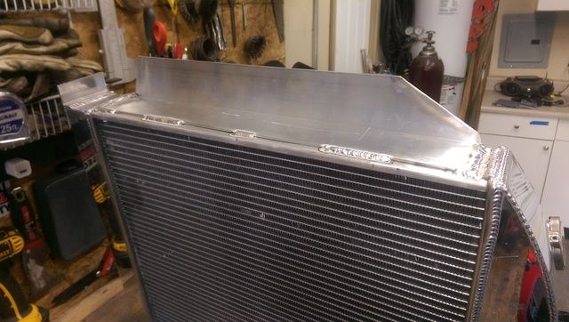

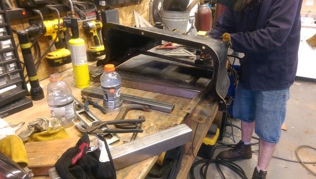

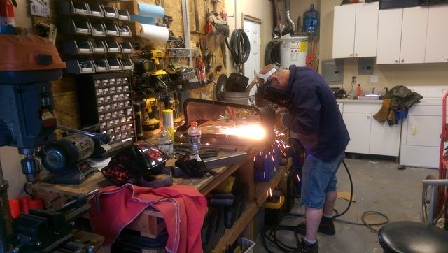

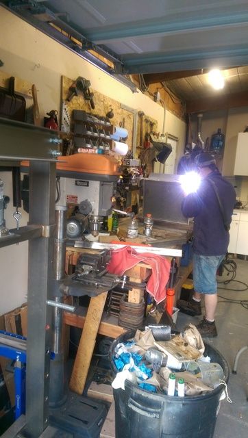

Went to see friend "Pyro" last night. He welded the new flanges on the radiator and used his plasma cutter to remove some metal from the radiator housing to make it fit.
Dawgvan: A '64 A100 Build thread - Page 6 IMAG1364_zpseh789uon
Dawgvan: A '64 A100 Build thread - Page 6 IMAG1365_zpsp53xs4bz
Dawgvan: A '64 A100 Build thread - Page 6 IMAG1363_zps5ngp72zt
Dawgvan: A '64 A100 Build thread - Page 6 IMAG1372_zpsgpzm3qbg
Dawgvan: A '64 A100 Build thread - Page 6 IMAG1376_zpsd1xgk4h4
And the fitting!
Dawgvan: A '64 A100 Build thread - Page 6 IMAG1381_zpsprclh1hk
Dawgvan: A '64 A100 Build thread - Page 6 IMAG1382_zpsptpd6yos
Dawgvan: A '64 A100 Build thread - Page 6 IMAG1383_zpshuyijz1v
Next steps?
Final fitting and trimming of Radiator housing and radiator. Drill the mounting holes.
Strip, Ospho, prime, and paint the housing. Ten Paint the inside wall with heat ablative ceramic paint using this stuff:
http://www.hytechsales.com/insulating_paint_additives.html
Strip, Ospho, prime, paint the floor.
Mount the radiator.
Repaint the rest of the housings with the thermal paint
Miller Time!
