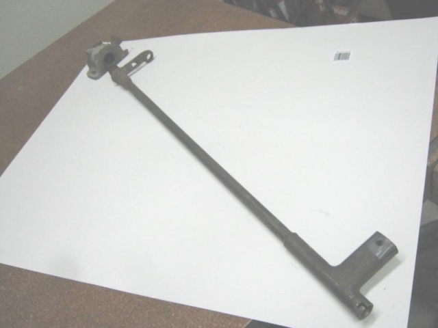

ALL right moving right along while I have everyone's attention and the wheels are still turning can I install a 68 2nd GEN auto steering column in a 66 1st GEN van with out any major modifying I read somewhere on a post that they attach differently at the steering box??? ........... where are you donivan 65?

,,,,,I'm right here,,,,,,the 2nd Gen uses a 1 piece shift lever shaft, while the 1st Gen uses a 2 piece shaft,,,,,,but bottom line is they both fit the steering box,,,,,so if you get a 2nd gen steering column,,,,,get the whole column and the lever assembly off the steering box and the shift rod going back to the trans,,,,,

THANK YOU donivan 65 I knew you would know the answer you are defiantly the question and answer king of Early's thanks for the photo also. ............JOE VAN..............back to the garage.
