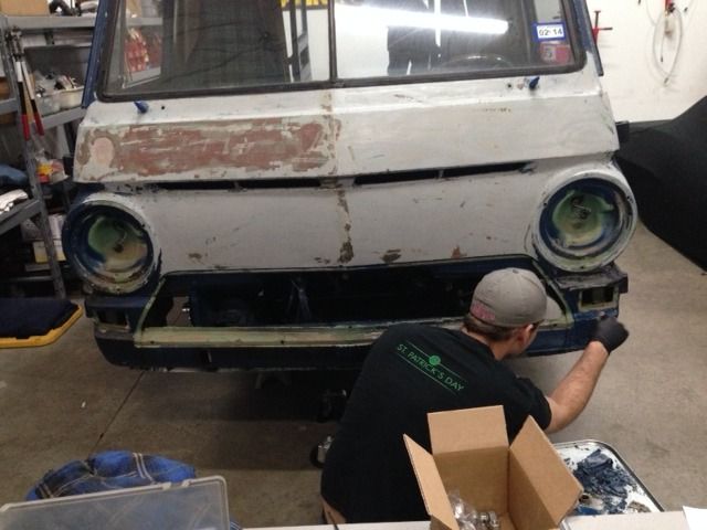

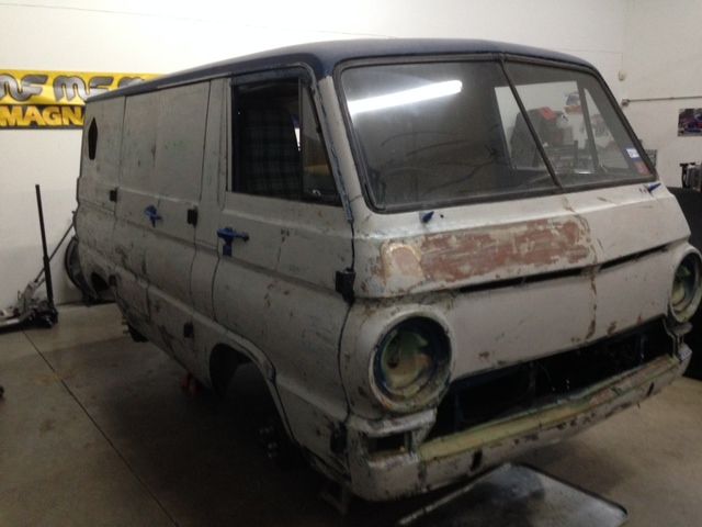

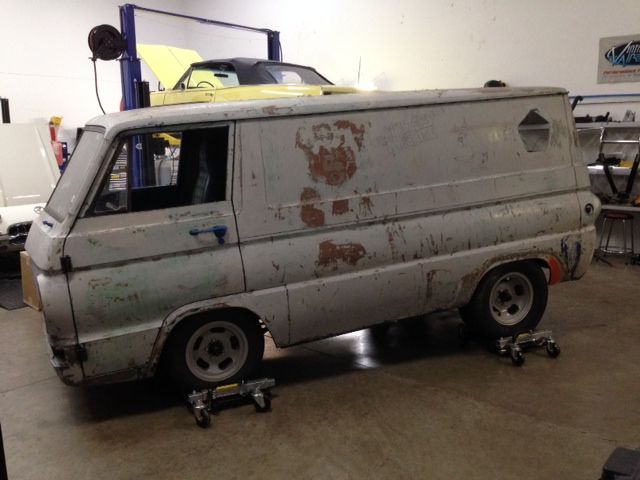

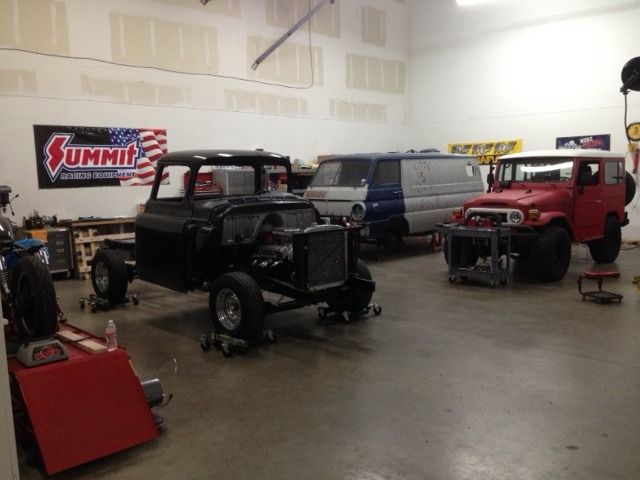

Here it is as of today. The primer is good whatever they used when they repainted it in the late 70's. I chose to use aircraft stripper because I had free help and I didn't want the shop dusty and keep the mess down. Thanks to my buddy Bryson for getting after it.

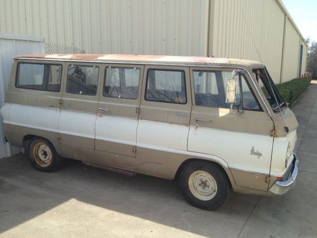

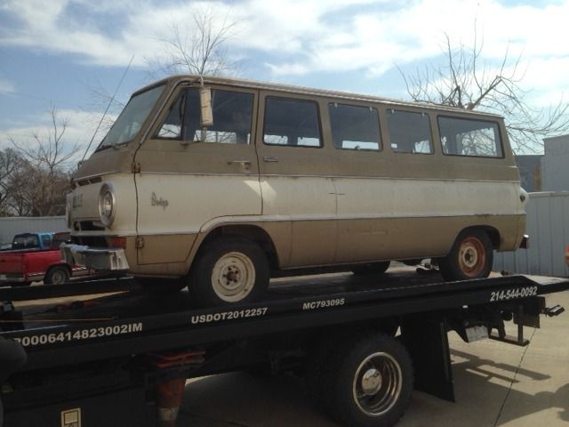

I picked up a titleless a108 for $500 locally. The van is all original and complete with a 318 and auto. Its so nice I am getting hesitant to cut it up! Im thinking of changing direction with the a100 and use the 318 from the a108 because I'm in it so cheap. Decisions!

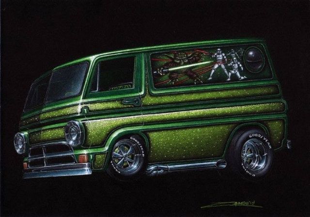

Here is the cool scheme I found that I just love besides the root beer metallic.

Thanks Vanny but I can't take credit for that artwork. That was done by a professional and I won't have anything on the sides. Also, I Cleaned out the a108 yesterday. I put a battery in it and the radio came on! No shit, the lights came on and it tried to crank. She is just way too clean. I just can't cut it up. I'm going to get her running and see what happens from there. I think I can get the title pretty easily.

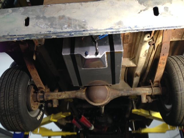

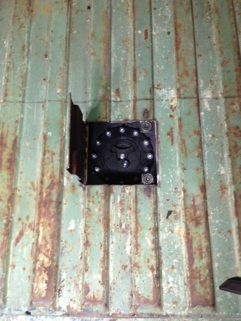

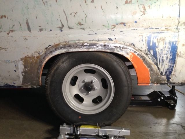

Made a little progress on the van. Holding off on the air ride for now to get it mobile and out of the way in the shop. I went ahead and did a front axle flip. I also lowered the rear by removing 3 leaves. Got a fuel cell installed and got the drivers wheel opening tacked on place. Almost complete with the body work. Heres some pics of the progress..

Thx guys , I haven't had a chance to drive it yet dodge man but I think I figuired out the issue w the ride. The caster gets thrown way off and the axle actually has to be moved backward an inch as well. I built in all the corrections into the spring mount I made. Only thing I may need to do is put on shorter bump stops. Again, this is most likely temporary untill I have time to do the full airride which will require a lot of fab work.
