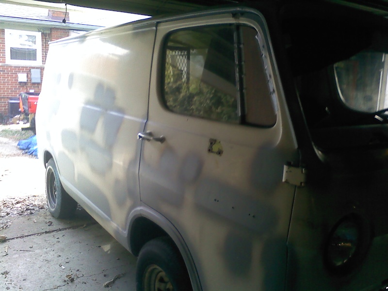

farther & son project 66 no-door
well my son michael has expressed intrested in my 66 no-door told him he helps and works on it i will give it to him with vistation user rights.this will kill 2 birds with one stone.i still get to work on the 70 4x4.as of today i have a bult 283 small block i guess to call it in today times it is a 302 now been behine it will be a bult up T-350 with a 3000 stall. van has a 12 bolt in it don,t know gear raito yet i,m guessing a 3;73 would go nice with this set up.planning on stripping it down a roller in april and sending it to meada blast depending on cost.anyone ever strip a van here there self ?

RodStRace- Number of posts : 3046
- Post n°5
Re: farther & son project 66 no-door
Nice to get the next gen involved!
I got a big quote from the local soda blaster. I decided I'd go another way. Check your local guys, they may be reasonable!
Sand can warp, so avoid it if possible, unless the guy is a serious pro at sheet metal.
You can use a DA and 80 grit paper. It'll give the kid something to start on! Lots of effort!
The other way is to use aircraft stripper. Messy, noxious and to need to worry about it seeping into seams.
I stripped most of my van(original paint and a layer of house paint) with a wide razer blade. I took it alway to the red qxide primer this way then DA the rest to metal. I learned this from a buddy that strips vettes this way Bob
i was thinking on getting a 110 lbs harbor ft sandblaster and getting meada blasting compound and have my son go panal by panal do the hole inside and underneath.
I used paint stripper and sand blasting and everything else!
If you are going to be working with multiple layers of paint the stripper works pretty good, use it on the flat panels or anywhere you wont get a seep like Rod mentioned (not on drip rails!). I used sand on spots that I didn't have to worry about warping like around the head lights and some of the harder to sand body lines up by the roof and grill. after all that it was DA and a bunch of scotchbrite pads on a die grinder. If you use sand on the inside, you will be blowing that out for ever from behind the ribs and roof rails. Just keep that in mind before you start spraying paint on the inside,, spend some time getting it out if you use it.
