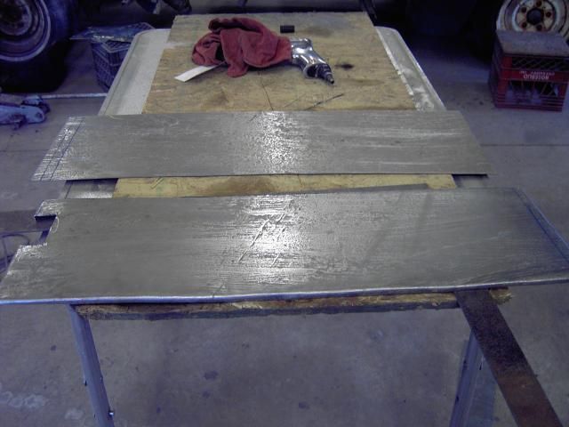

got the skin mocked up....a little more prep work and I can weld the skin on.....

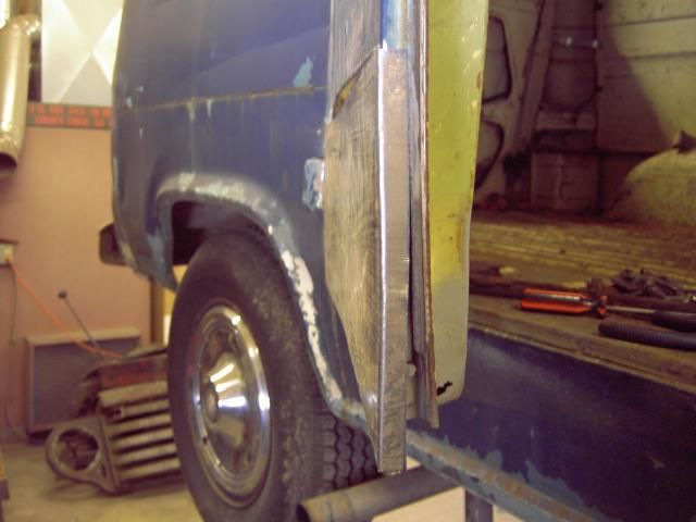

removed all the excess old door skin metal,completed welding on the patch panels, put the zinc too it,
ready to weld on the new door skin panel....

I got a good start on the door skin patch panel.....
Re: my falcon econoline van
Post by Big W on Mon Dec 24, 2012 9:55 am
Those are comeing along nicely coupe. Just a side note: Keep a close eye on the hieght of both doors when putting on your skins. I thought mine were good untill I put both back doors side by side and found out they were about a 1/16" different. Nothing I can't fix, but the doors are in primer ready for paint if I ever need them.

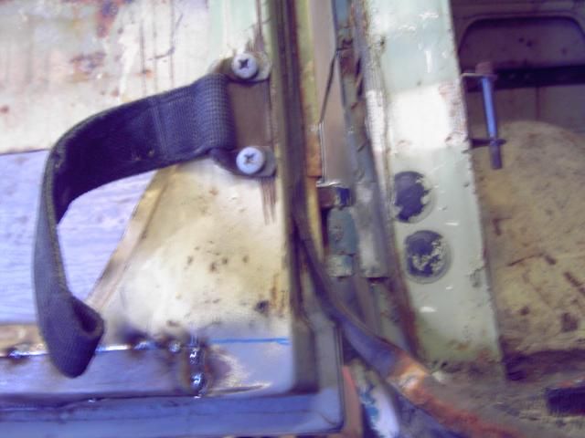

you guys are ok......well the doors aren't finished yet because I moved on to the windshield. The gasket was as hard as a rock. I ended up cutting a grove on it with a cutting wheel ,then prying it off with a window glaze cutting putty knife.There was this "plumbers" like putty smeared in the window channel..what a mess. Adhesive cleaner and elbow grease did the trick to clean it up.Hardly any rust or rot through in the window channel.Real nice.Primed her up and tonight my buddy and I will install the windshield with a new gasket.....

Coupe great job on the doors, They look a whole lot better. Just a quick note if you haven't allready put in that windshield. Where the nose overlaps the windshield post, put some por15 or something to keep rust out of that seam. My windshield guy sprayed some stuff into those 2 areas and after it bubled and ate the rust out it became solid. I presume it turned the rust into carbon and then he sanded and sealed both areas. no more rust for me in those seams for as long as I own this van and then some...lol. I opted to not put in any window eurothane sealer or what ever it's called in the seal becus my new seal fits very snug, and the window guy said don't need it anyway. just a couple of cents worth of info for you.

Well, my buddy and I got the windshield installed. We've installed several windshields, especially on older vehicles. This van was the hardest. The challenge was getting the rubber gasket on the glass. My buddy is very patient and talented. Persistence and strenght won. Here it is....real sweet...

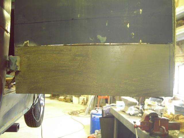

back at it.....started repairing the rear pass. door. instead of a patch panel I'm just going to weld the rusty holes. Turned the amps. down to A and wire speed to 1 1/2, that's on a Lincoln wire (MIG) welder...so far so good.....

Well I gave up trying to fill the rust holes. I was doing fairly well, but today I had enough. She was getting really warped,and it's going to workout much better with a new lower door skin........here it is so far...
