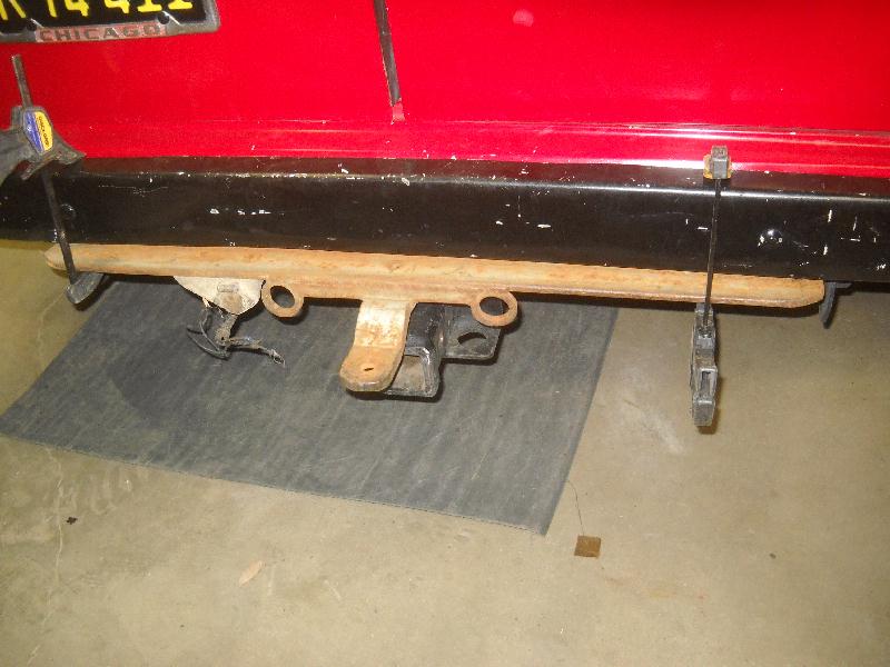

i plan on doing one similar to donavans but right now, i have a hitch i bought for 20.00 and cut ends off, welded on tabs and welded tabs to bumper brackets. it was last minute decesion to drag camper to nats. and took longer to go get hitch than to install. i am not pleased with how it sticks out but need to drop tank to weld the way i want. click on pic to see entire pic
