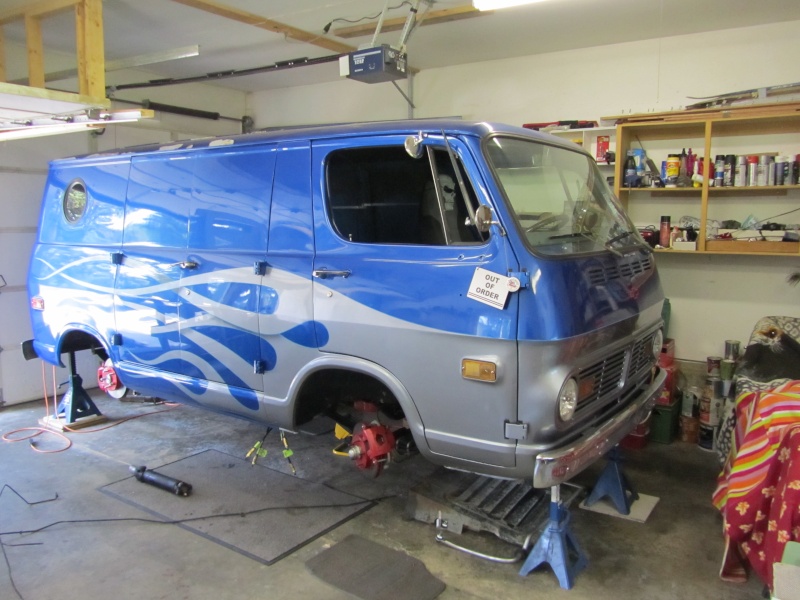

July 2, 2013. We have completed as much of the fabricating and welding as possible for now. Time to trailer the old girl to her new home where I will finish the the rest of the project. Many thanks to my buddy Gary for helping and the use of his garage.
Home sweet Home: Now I can work on her when every I feel......exciting Smile

Post by vanny on Tue Aug 20, 2013 4:19 am
Love that color blue and the 3D flames really pop! Sign should say Temporarily Out of Order.

That is really looking SWEET! Love the four wheel disc brakes bounce
Re: What would you do? LYRAD'S PROJECT
Post by G-Man on Tue Aug 20, 2013 6:54 am
One sweet 2nd gen for sure
