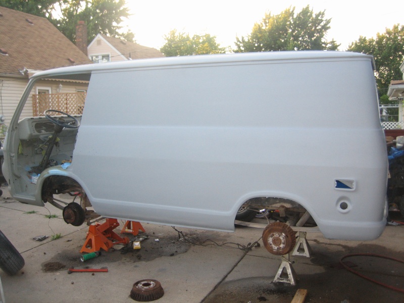

Post by Bear on Thu Jan 06, 2011 6:34 pm

Bear is this the blue van you had a while back? Bill
Re: my 1970 soon to be 4x4
Post by EconoCarl on Thu Jan 06, 2011 6:39 pm
Lookin' good so far!
Keep the camera handy!

yes bill this is my 90 wb i sold the 1969 108 sorry i did but i need the room.then 2 yrs later i buy a bigger house huge garage that would have housed all three vans. thats life.

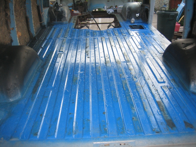

70 dog house removed
Post by Bear on Mon Jan 10, 2011 1:14 pm

Post by Bear on Mon Jan 10, 2011 1:16 pm
i have seen alot of talk about removeing a dog house from cuting lots of floor with it.heare is how i did mine in my 1970 i drilled each spot weld and lifted it with a flat bar.

my dog house on the 70 will be removeable to work on things
