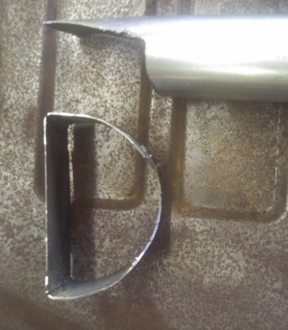

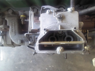

OK, so I've been working on the 250 I plan on swapping into the Sportvan. I did a 2bbl carb conversion using a Motor-Craft 2100.
The only issue was there's not enough room in the DH for the full carb so mounted it sideways and cut off half the horn! (Switching to cable so throttle linkage is not an issue).
Ran it on the stand and it runs GREAT! She finally gets to breath the way she should! Instant power, real throaty and no more carb whistle form the motor trying to suck air through that old mono-jet! Anyway, now had to address the Air-Cleaner assy issue I had by cutting the horn. So I got real creative and this is what I did:
1- Picked up a few 2 1/2" and 3" exhaust pieces and sheet metal. And one really cool cone filter!
2- Cut the short 3" piece to open it up to make a half circle to match the carb. Cut a flat piece and welded it in to make a big "D".
3- Cut a 9" section of the 2 1/2" and notched it to fit the "D" at a 90 degree. Also cut the face of the "D" to match the side pipe.
4- A couple of test fits.....
5- Filled in the corner holes on top and tested again...
6- Cleaned it up a bit, made a gasket and called it good! Runs great and even looks kinda cool!
*** And it sits no higher than the original stock air cleaner assy!

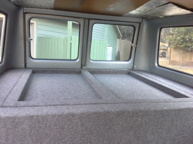

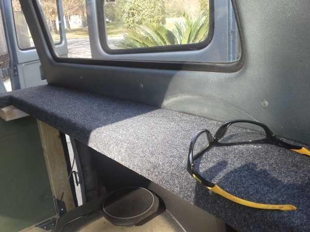

Just a little update. Some of you know my health has had it's issues over the last year or so. But slowly recovering and did get out today and got some work done on the van. Been planning on putting a rear deck in for a few years and was feeling really good today so I went at it today. Came out looking better than I had expected... Smile
** And Yes, That center section is removable! Wink

That rear deck of yours is super practical! Gives you a place to stash stuff out of site. And nicely done, how you ran it up to the window frame trim. What did you cover it with? I like how the removeable top has the inset areas to keep stuff from sliding around in there. I might suggest leaving an opening in the front of the box for access through the side door (and an opening in the back, if there isn't one).
