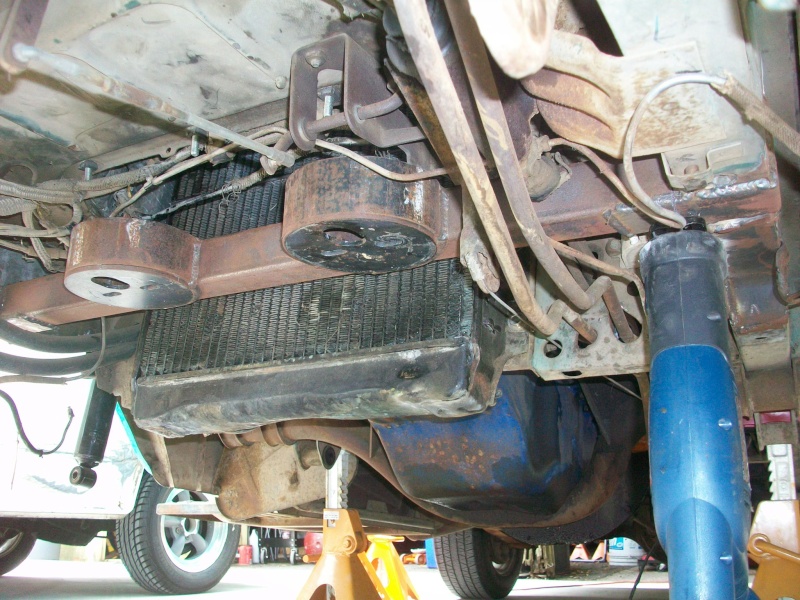

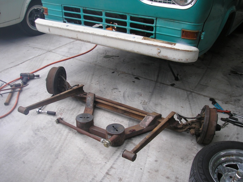

Got all of the leaf springs and front axle out of the '67 Heavy Duty today. A local frame and front end shop had the bushings in stock so we'll be replacing them. Below is a pic of the artwork we removed from under the front end of the turquoise van! We'll attack it again tomorrow.

Got a lot done today. Had all of the bushings replaced in the springs and pulled the second longest leaf out. Got the front axle cleaned up and ready to install. Removed the big-a$$ bracket that held the bags and cut off a plate that was covering the sway bar attachment points. Straightened the badly tweaked shift rods (boy were they in a bind!). Took the D&D Master Cylinder off of the white van and installed it in the new one. Belly pan from blue van is painted and ready for install. Should have the front end all done Sunday.
Danny cleaning the crap off of the axle. The king pins on the turquoise van's axle were actually the best of the three.
Cutting off the bracketry for that held the airbag set up. This has gotta' help out with cooling!
