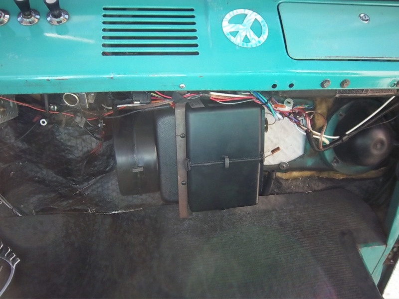

Removed the heater assembly:
Installed the air vent box from the driver's side of a parts van to the right side:

To make more room for the Evaporator/ Heater box something had to be done with the wiper motor. First thought was to have it mounted parallel to the floor to allow for more room, which meant having to reclock the arm so the wipers would park correctly. I removed the wiper motor with bracket attached to see if it could be mounted upside down. Using the original holes the motor hit the top of the dash, but making brackets to drop the motor down one inch it fit perfectly. In this location the shaft coming out of the motor is where it came from the factory. All that was left to do was move the arm bolted to the motor 180 degrees.
Now the wiper motor is well out of the way. The original was a single speed, so while I was at it I converted to a 2-speed wiper motor.

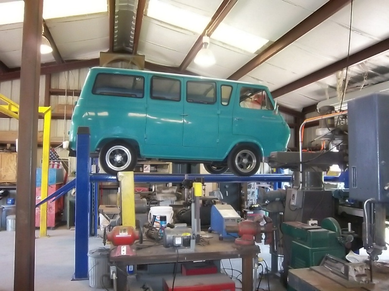

Got the inside unit and condenser installed last week.
Nice having a friend with a large tool/machine filled back yard shop!
Made two brackets to hold the inside unit. One bracket across the back between the wiper motor and the old vent on the passenger side (ended up having to remove the vent and make a plate to cover the hole). The other bracket in front hanging from the dash to the A/C.
Mounted the condenser (with electric fan) under the left side, opposite the side doors:
