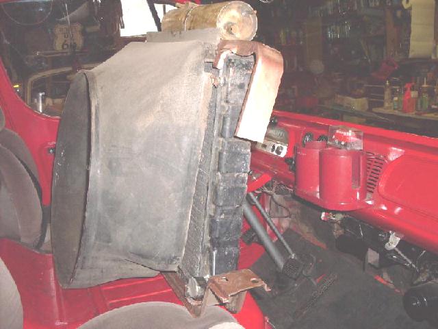

Has anyone sourced new 2nd Gen radiators?

Which radiator do you have in there,,,,a downflow or a crossflow?
Re: 1st Gen Heater Core
Post by Guest on Wed Jan 04, 2012 10:01 am
Downflow. The 2nd Gen 6Cyl radiator in your more than excellent photo is it I believe.

The crossflows have a surge tank on top,,,,,there is no radiator cap on that 4 row of tubes radiator,,,,,and you could of ordered this set up on a 6 cylinder,,,,,,

I see new radiators like this listed for my vehicle. What are the dimensions of the one in the photo and do you know if/where the brackets would be available?

I would say they only think they have a radiator that fits your van,,,,,,the upper mount is welded to the bump outs in your doghouse,,,,the lower is bolted to your frame,,,,,it needs a recirc line that goes into your upper hose to get the air out of the system,,,,those are all wrecking yard parts,,,,,and if you have the 4 row radiator,,,,,,you got the best cooling Chevy Van radiator out there,,,,,,I thought about putting in that 2nd Gen cooling system,,,,but I changed my mind,,,,,
